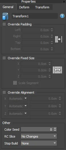

To adjust the padding, alignment or transform settings of a segment:
- Wire the segment to the transform node's input.
- In the Transform node's properties, activate any settings you wish to use by clicking on the appropriate tick-box. This will override the values set in the Segment's properties.
- If necessary, expose settings so that they can be controlled by numeric, constant, or arithmetic operators by right-clicking on the Transform node and selecting Export>Properties
- Connect the Transform nodes output to the generator or another operator's input.
Interface
Padding. controls the distance between adjacent segments with separate controls for left, right, top and bottom.
Fixed Size. controls the size of the segment. If Scale Mode is off the values are used only for calculating the position of adjacent segments.
Alignment. selects the pivot point position used to calculate the location of the segment on the X, Y, and Z axis
Pivot Offset. iffsets the pivot of the source geometry on the X,Y and Z axis. Pivot alignment should be used to see the effect.
Transform Fixed. allow you to adjust the translation, rotation and scale of a segment.
Transform Random. Allows you to randomise the translation, rotation and scale of a segment by picking values from a range defined by a minimum and maximum value.
Color Seed. used with RailClone Color to coordinate the randomisation of maps and tints, segments with the same colour seed in the same part of the array will get the same map and tint.
RC Slice used with RailClone Slice that allows you to slice a mesh into multiple segments. This dropdown allows you to select the slice to use. Stop Build allows you stop the building process at different levels even though there is still geometry attached. Options include None, Sub-Spline, Spline, Array or All.
For detailed explanations of padding, alignment, transforms and randomisation please see the Segment reference.
