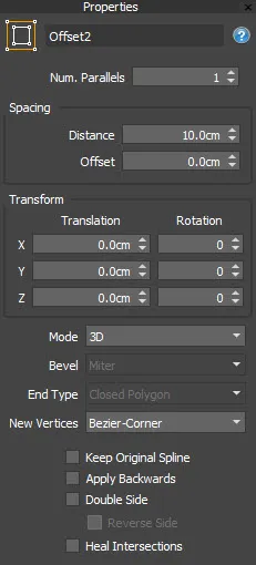

Interface & Parameters
Interface
Spline offset tool interface for precise design adjustments
# Parallels
Specifies the number of times the input spline is duplicated.
Spacing
Controls the incremental offset of the cloned splines using two parameters
  • Distance sets the offset distance between each parallel
  • Offset Allows you to modify the offset value for just the first parallel.
Rotation
Incrementally rotates splines using the stepped values set for the X, Y, and Z axes.
Translation
Incrementally translates the splines using the values set for the X, Y, and Z axes.
Mode
SplineOffset includes two algorithms for performing offset and healing operations: 2D Mode and 3D Mode.
