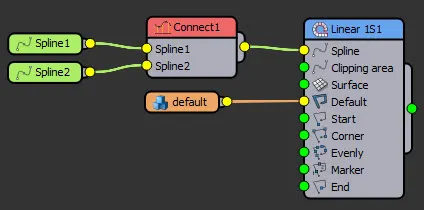

The Connect operator generates straight segments between two splines, using the vertices or markers on the first spline to determine the number and position of connections. This is useful for procedural frameworks, structural designs, and creating networks of connected elements.
Usage
- Add the Connect Operator: Drag the Connect node into the RailClone Style Editor.
- Connect Two Splines: Attach two splines as inputs (Spline A and Spline B). The corner vertices on Spline A will determine the number and position of connections.
- Choose a Projection Mode: Select how connections are generated:
- Perpendicular: Draws connections at right angles from Spline A to Spline B.
- Vertical: Creates vertical connections between the two splines.
- Position: Matches connection points based on proportional positioning.
- Enable Additional Features: Use Filter by Material ID, Add Start/End, or Align Segments with Spline for finer control.
