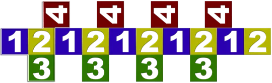

The compose node allows you to build a new geometry object by combining several segments together. When attached they will array along the path one after the other (similar to the sequence node, above). However, when used in conjunction with a Segment's padding and transform settings, segments can be moved rotated and scaled on any axis to make a complex composite object.
4 segments combined using a compose node (marked with a white outline)4 segments combined using a compose node (marked with a white outline)
