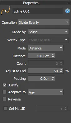

Divide Evenly
Divide OperatorInserts evenly spaced vertices along the spline.
- Divide by:
- Distance: Places vertices at regular intervals based on the set distance.
- Count: Specifies the total number of divisions.
- Vertex Type: Defines the type of new vertices (Corner, Bezier-Corner).
- Mode:
- Distance: Uses a fixed distance for divisions.
- Adaptive: Adjusts divisions based on spline curvature.
- Adaptive To: Specifies how adaptive mode applies (e.g., Any curvature).
- Reverse: Reverses the placement order of new vertices.
- Set Mat.ID: Assigns a material ID to the newly created segments.
- Padding: Adds an offset at the start and end before placing the first and last vertex.
